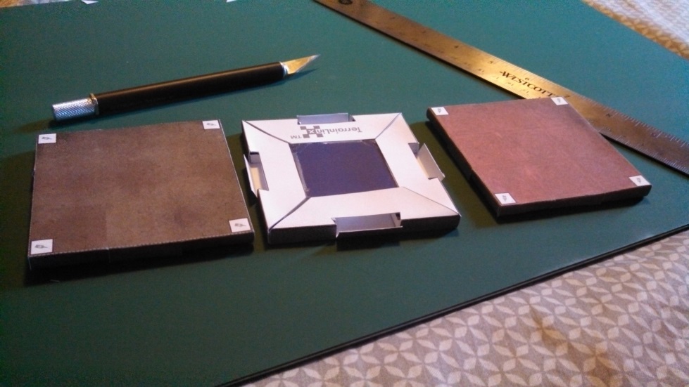

Hi! I'm totally new to TLX, and even papercraft in general, so this is a totally basic question. I'm building my first TLX floor pieces, and I don't understand the tabs on the sides where the connectors go. I bought the Thoumont's PDF, and it has two green lines to show a cut on each edge. Is that all I cut, or do I cut that entire tab? If I cut the tab, how do I fold it or what do I do with it?
I've looked at various pictures and videos, and searched around on the forum, but I'm just not seeing anything clear on that. Any insight would be appreciated!

That trapezoid you're now cutting out will make it easier to slot in the tabs. You insert the tabs at an angle and kind of rotate them into the slot as they slide in. I am pretty sure there's a promo video that probably demonstrates that somewhere...
A little story about my early crafting...
When I did my first set of tiles, I fell in love with spray glue (super77, which I still use a LOT). I sprayed the back side of the tiles and then mounted the foamcore to it. It made assembly VERY quick. When I went to assemble my first floor plan, I realized my error. Because I had sprayed glue everywhere on the back of the tile texture, there was glue even in the slots for the connecting tabs. My tiles ended up stuck together, and I made a mess of several trying to get them apart!
Lessons learned - when you're assembling the tiles:
1) Do a dry-run to make sure the tile is cut well and the cardstock will wrap around it correctly. 2) When doing the dry-run, make sure the slots on the foamcore are wide enough and well positioned so those side flaps can swing freely 3) When gluing things together, make sure to not apply glue where the slots are, or else your tabs will get stuck! 4) I recently bought a pen set that has a plastic stand for them all. It's sturdy and gives me a great square edge to press the tiles against. I use this to ensure that my sides are perfectly square. If you're eyeballing it, try to not let the sides angle outwards at the bottom, or else the tiles won't fit snugly together. 5) If you're edging, do it before gluing the tiles. It delays gratification quite a bit, but is quite a bit easier than edging after the fact (I think). If you're not edging, consider edging. It makes the pieces look quite a bit better (I think). If possible, pick a color that somewhat matches the tile. If all else fails, a light grey will often fill in without standing out too much.
Phew. I type too much. Glad you've joined the forums, and I hope you can post some pics of your progress!

Here is a shot of my first 3 tiles, I flipped one upside down to shot the gluing I did. I am going to switch to walls now, and make this a little room to see how it all fits together thus far. For my first floor tile I didn't score it (hadn't watched the videos, just winged it).
I'm using a scotch "wrinkle-free" glue stick - it was all I could find at Staples that said it was for papercraft. I applied the glue to the foamcore instead of the cardstock for my 2nd and 3rd floor, that seemed to work much better. I also ended up with a piece of blue foamcore, but didn't figure that would matter too much.

First - the corner connectors when glued on seem rather springy or loose. Any suggestions on how to attach those more firmly, or is that normal? (I've given them time to dry, but perhaps they take longer than I expected)
Second - which is more normally used, the anti-warp walls, or regular walls?

I love the non anti-warp walls. So incredibly fast to make. They are just fine for interior walls that you don't need the flat surface to support an upper outside wall.
While I do agree the edging part is mandatory, I prefer to do most of mine later.

I did a single page of walls, and think I'll just continue with the 50/50 mix of anti-warp and regular. Fixed some of my anchors so they're more firmly attached, my particular glue doesn't seem to like those, but has been good for the other bits. Not sure why that would be.

I tend to use something like superglue for the anchors. Also, be aware that they DO come off during assembly (or more likely, disassembly!), so when you get too many of them, DON'T through the extras away!

I tried superglue for an anchor last night out of frustration, and yeah, that works quite well!
