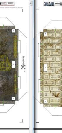

I have also purchased a Cameo recently. I haven't tried just coloring in the block registration mark but using the little cutouts that MelEbbles released. If I don't, then the tiles seem to get cut out slightly crooked when using the L-shaped registration marks.
Also, some of the Titan Control 6"x6" tiles are not centered properly between the registration marks, which causes the cuts to be shifted 1/4" up (towards the titan logo at the top of the page) in comparison to the printed image. Attached is an image of what I'm talking about. Ignore the black between the registration marks.
MelEbbles, I'd be willing to test out anything you need to regarding the cameo. Just send me a PM. I'll try to check daily.

Sprocket Joined: 01-22-2013, 07:51 PM Posts: 4
There are some tiles that are not centered correctly. I've attached an image of a Streets of Titan 6x6 tile next to Titan Control 6x6 tile. As you can see the reg marks and title bar at the top of the pages are even but the Titan Control tile is shifted slightly down.

WorldWorks Moderator Joined: 08-05-2005, 01:03 AM Posts: 1129
Nice work Slowbad I went through all the Titan sets tonight, and found the problem. I passed the info on, and hope we shall see a fix coming down the pipe ASAP....I shall keep you posted
