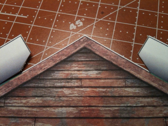

So tonight I fixed up the 6" walls that needed their little cutouts, and I printed out two full sets of 6" walls, and the 2nd of the sets of 3" walls. My robocutter and I have been busy retelling the papercraft story of John Henry. I am no match for the machine, however. I've been doing the scoring, then using the cutter to only, well, cut. My blade is super-dull at this point, so I'm double-cutting each sheet. Waiting for the perforating to finish was killing me.
For whatever reason, the 3" pages all cut perfectly, but the 6" pages just don't seem lined up (or scaled right, for that matter) with the cuts. It slowed me down a bit, but I had to tweak the 6" cutfiles for each page. I'd really like feedback to find out if I've done something wrong with some of my pages, or if in fact the cutfiles are off a bit. I'm happy to submit all my files with "fixed" cutfiles - I just hadn't figured on spending time doing that.
I have 8 more pages to go, but I'm too tired to cut any more pieces... I'll start making mistakes like feeding pages in upside down... I've got a little over an inch high stack of wall pieces to edge now. Tomorrow I'll print and cut a couple sets of the roof pieces, and if I still have any cardstock left, I'll print some flat roof pieces.

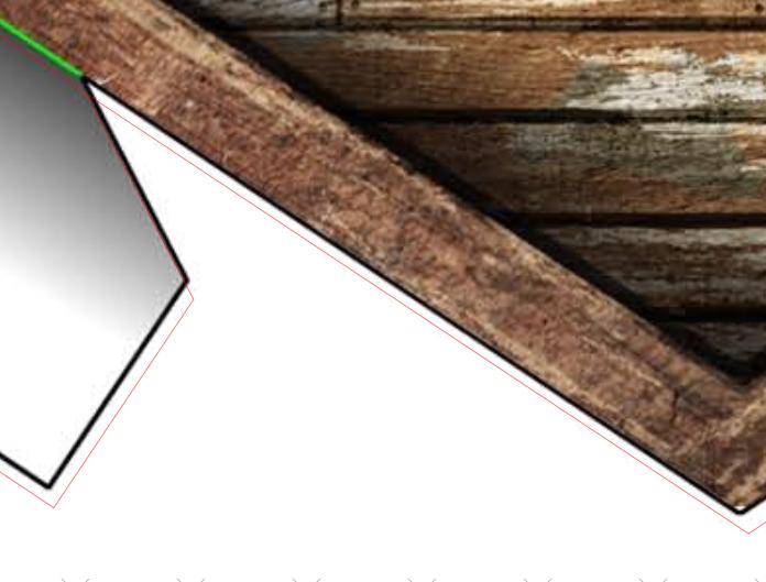

I pulled the deadfall pdf into GIMP and immediately exported it. I brought that image into Studio, and this is what I see at the bottom of the page:

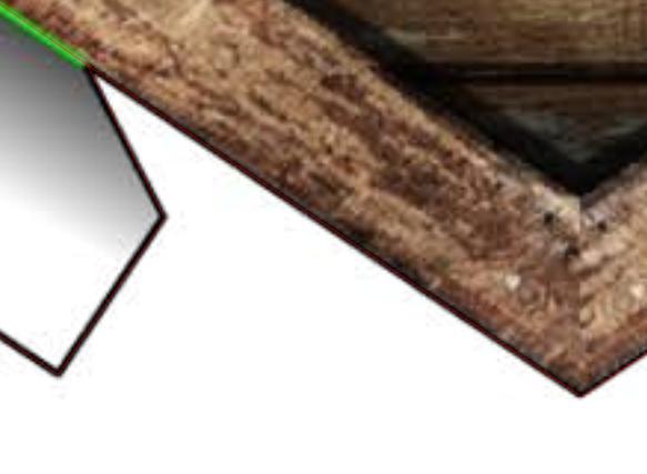

I didn't see this on my 3" pages. Here's a shot from the exact same process with a 3" wall:
[phpBB Debug] PHP Warning: in file /includes/functions_reimg.php on line 122: preg_match_all(): The /e modifier is no longer supported, use preg_replace_callback instead [phpBB Debug] PHP Warning: in file /includes/functions_reimg.php on line 124: array_unique() expects parameter 1 to be array, null given [phpBB Debug] PHP Warning: in file /includes/functions_reimg.php on line 126: Invalid argument supplied for foreach() [phpBB Debug] PHP Warning: in file /includes/functions_reimg.php on line 122: preg_match_all(): The /e modifier is no longer supported, use preg_replace_callback instead [phpBB Debug] PHP Warning: in file /includes/functions_reimg.php on line 124: array_unique() expects parameter 1 to be array, null given [phpBB Debug] PHP Warning: in file /includes/functions_reimg.php on line 126: Invalid argument supplied for foreach() [phpBB Debug] PHP Warning: in file /includes/functions_reimg.php on line 122: preg_match_all(): The /e modifier is no longer supported, use preg_replace_callback instead [phpBB Debug] PHP Warning: in file /includes/functions_reimg.php on line 124: array_unique() expects parameter 1 to be array, null given [phpBB Debug] PHP Warning: in file /includes/functions_reimg.php on line 126: Invalid argument supplied for foreach() [phpBB Debug] PHP Warning: in file /includes/functions_reimg.php on line 122: preg_match_all(): The /e modifier is no longer supported, use preg_replace_callback instead [phpBB Debug] PHP Warning: in file /includes/functions_reimg.php on line 124: array_unique() expects parameter 1 to be array, null given [phpBB Debug] PHP Warning: in file /includes/functions_reimg.php on line 126: Invalid argument supplied for foreach() [phpBB Debug] PHP Warning: in file /includes/functions_reimg.php on line 122: preg_match_all(): The /e modifier is no longer supported, use preg_replace_callback instead [phpBB Debug] PHP Warning: in file /includes/functions_reimg.php on line 124: array_unique() expects parameter 1 to be array, null given [phpBB Debug] PHP Warning: in file /includes/functions_reimg.php on line 126: Invalid argument supplied for foreach() [phpBB Debug] PHP Warning: in file /includes/functions_reimg.php on line 122: preg_match_all(): The /e modifier is no longer supported, use preg_replace_callback instead [phpBB Debug] PHP Warning: in file /includes/functions_reimg.php on line 124: array_unique() expects parameter 1 to be array, null given [phpBB Debug] PHP Warning: in file /includes/functions_reimg.php on line 126: Invalid argument supplied for foreach() [phpBB Debug] PHP Warning: in file /includes/functions_reimg.php on line 122: preg_match_all(): The /e modifier is no longer supported, use preg_replace_callback instead [phpBB Debug] PHP Warning: in file /includes/functions_reimg.php on line 124: array_unique() expects parameter 1 to be array, null given [phpBB Debug] PHP Warning: in file /includes/functions_reimg.php on line 126: Invalid argument supplied for foreach() [phpBB Debug] PHP Warning: in file /includes/functions_reimg.php on line 122: preg_match_all(): The /e modifier is no longer supported, use preg_replace_callback instead [phpBB Debug] PHP Warning: in file /includes/functions_reimg.php on line 124: array_unique() expects parameter 1 to be array, null given [phpBB Debug] PHP Warning: in file /includes/functions_reimg.php on line 126: Invalid argument supplied for foreach() [phpBB Debug] PHP Warning: in file /includes/functions_reimg.php on line 122: preg_match_all(): The /e modifier is no longer supported, use preg_replace_callback instead [phpBB Debug] PHP Warning: in file /includes/functions_reimg.php on line 124: array_unique() expects parameter 1 to be array, null given [phpBB Debug] PHP Warning: in file /includes/functions_reimg.php on line 126: Invalid argument supplied for foreach() [phpBB Debug] PHP Warning: in file /includes/functions_reimg.php on line 122: preg_match_all(): The /e modifier is no longer supported, use preg_replace_callback instead [phpBB Debug] PHP Warning: in file /includes/functions_reimg.php on line 124: array_unique() expects parameter 1 to be array, null given [phpBB Debug] PHP Warning: in file /includes/functions_reimg.php on line 126: Invalid argument supplied for foreach() [phpBB Debug] PHP Warning: in file /includes/functions_reimg.php on line 122: preg_match_all(): The /e modifier is no longer supported, use preg_replace_callback instead [phpBB Debug] PHP Warning: in file /includes/functions_reimg.php on line 124: array_unique() expects parameter 1 to be array, null given [phpBB Debug] PHP Warning: in file /includes/functions_reimg.php on line 126: Invalid argument supplied for foreach() [phpBB Debug] PHP Warning: in file /includes/functions_reimg.php on line 122: preg_match_all(): The /e modifier is no longer supported, use preg_replace_callback instead [phpBB Debug] PHP Warning: in file /includes/functions_reimg.php on line 124: array_unique() expects parameter 1 to be array, null given [phpBB Debug] PHP Warning: in file /includes/functions_reimg.php on line 126: Invalid argument supplied for foreach() [phpBB Debug] PHP Warning: in file /includes/functions_reimg.php on line 122: preg_match_all(): The /e modifier is no longer supported, use preg_replace_callback instead [phpBB Debug] PHP Warning: in file /includes/functions_reimg.php on line 124: array_unique() expects parameter 1 to be array, null given [phpBB Debug] PHP Warning: in file /includes/functions_reimg.php on line 126: Invalid argument supplied for foreach() [phpBB Debug] PHP Warning: in file /includes/functions_reimg.php on line 122: preg_match_all(): The /e modifier is no longer supported, use preg_replace_callback instead [phpBB Debug] PHP Warning: in file /includes/functions_reimg.php on line 124: array_unique() expects parameter 1 to be array, null given [phpBB Debug] PHP Warning: in file /includes/functions_reimg.php on line 126: Invalid argument supplied for foreach() [phpBB Debug] PHP Warning: in file /includes/functions_reimg.php on line 122: preg_match_all(): The /e modifier is no longer supported, use preg_replace_callback instead [phpBB Debug] PHP Warning: in file /includes/functions_reimg.php on line 124: array_unique() expects parameter 1 to be array, null given [phpBB Debug] PHP Warning: in file /includes/functions_reimg.php on line 126: Invalid argument supplied for foreach() [phpBB Debug] PHP Warning: in file /includes/functions_reimg.php on line 122: preg_match_all(): The /e modifier is no longer supported, use preg_replace_callback instead [phpBB Debug] PHP Warning: in file /includes/functions_reimg.php on line 124: array_unique() expects parameter 1 to be array, null given [phpBB Debug] PHP Warning: in file /includes/functions_reimg.php on line 126: Invalid argument supplied for foreach() [phpBB Debug] PHP Warning: in file /includes/functions_reimg.php on line 122: preg_match_all(): The /e modifier is no longer supported, use preg_replace_callback instead [phpBB Debug] PHP Warning: in file /includes/functions_reimg.php on line 124: array_unique() expects parameter 1 to be array, null given [phpBB Debug] PHP Warning: in file /includes/functions_reimg.php on line 126: Invalid argument supplied for foreach() [phpBB Debug] PHP Warning: in file /includes/functions_reimg.php on line 122: preg_match_all(): The /e modifier is no longer supported, use preg_replace_callback instead [phpBB Debug] PHP Warning: in file /includes/functions_reimg.php on line 124: array_unique() expects parameter 1 to be array, null given [phpBB Debug] PHP Warning: in file /includes/functions_reimg.php on line 126: Invalid argument supplied for foreach() [phpBB Debug] PHP Warning: in file /includes/functions_reimg.php on line 122: preg_match_all(): The /e modifier is no longer supported, use preg_replace_callback instead [phpBB Debug] PHP Warning: in file /includes/functions_reimg.php on line 124: array_unique() expects parameter 1 to be array, null given [phpBB Debug] PHP Warning: in file /includes/functions_reimg.php on line 126: Invalid argument supplied for foreach() [phpBB Debug] PHP Warning: in file /includes/functions_reimg.php on line 122: preg_match_all(): The /e modifier is no longer supported, use preg_replace_callback instead [phpBB Debug] PHP Warning: in file /includes/functions_reimg.php on line 124: array_unique() expects parameter 1 to be array, null given [phpBB Debug] PHP Warning: in file /includes/functions_reimg.php on line 126: Invalid argument supplied for foreach() [phpBB Debug] PHP Warning: in file /includes/functions_reimg.php on line 122: preg_match_all(): The /e modifier is no longer supported, use preg_replace_callback instead [phpBB Debug] PHP Warning: in file /includes/functions_reimg.php on line 124: array_unique() expects parameter 1 to be array, null given [phpBB Debug] PHP Warning: in file /includes/functions_reimg.php on line 126: Invalid argument supplied for foreach() [phpBB Debug] PHP Warning: in file /includes/functions_reimg.php on line 122: preg_match_all(): The /e modifier is no longer supported, use preg_replace_callback instead [phpBB Debug] PHP Warning: in file /includes/functions_reimg.php on line 124: array_unique() expects parameter 1 to be array, null given [phpBB Debug] PHP Warning: in file /includes/functions_reimg.php on line 126: Invalid argument supplied for foreach() [phpBB Debug] PHP Warning: in file /includes/functions_reimg.php on line 122: preg_match_all(): The /e modifier is no longer supported, use preg_replace_callback instead [phpBB Debug] PHP Warning: in file /includes/functions_reimg.php on line 124: array_unique() expects parameter 1 to be array, null given [phpBB Debug] PHP Warning: in file /includes/functions_reimg.php on line 126: Invalid argument supplied for foreach() [phpBB Debug] PHP Warning: in file /includes/functions_reimg.php on line 122: preg_match_all(): The /e modifier is no longer supported, use preg_replace_callback instead [phpBB Debug] PHP Warning: in file /includes/functions_reimg.php on line 124: array_unique() expects parameter 1 to be array, null given [phpBB Debug] PHP Warning: in file /includes/functions_reimg.php on line 126: Invalid argument supplied for foreach() [phpBB Debug] PHP Warning: in file /includes/functions_reimg.php on line 122: preg_match_all(): The /e modifier is no longer supported, use preg_replace_callback instead [phpBB Debug] PHP Warning: in file /includes/functions_reimg.php on line 124: array_unique() expects parameter 1 to be array, null given [phpBB Debug] PHP Warning: in file /includes/functions_reimg.php on line 126: Invalid argument supplied for foreach() [phpBB Debug] PHP Warning: in file /includes/functions_reimg.php on line 122: preg_match_all(): The /e modifier is no longer supported, use preg_replace_callback instead [phpBB Debug] PHP Warning: in file /includes/functions_reimg.php on line 124: array_unique() expects parameter 1 to be array, null given [phpBB Debug] PHP Warning: in file /includes/functions_reimg.php on line 126: Invalid argument supplied for foreach() [phpBB Debug] PHP Warning: in file /includes/functions_reimg.php on line 122: preg_match_all(): The /e modifier is no longer supported, use preg_replace_callback instead [phpBB Debug] PHP Warning: in file /includes/functions_reimg.php on line 124: array_unique() expects parameter 1 to be array, null given [phpBB Debug] PHP Warning: in file /includes/functions_reimg.php on line 126: Invalid argument supplied for foreach() [phpBB Debug] PHP Warning: in file /includes/functions_reimg.php on line 122: preg_match_all(): The /e modifier is no longer supported, use preg_replace_callback instead [phpBB Debug] PHP Warning: in file /includes/functions_reimg.php on line 124: array_unique() expects parameter 1 to be array, null given [phpBB Debug] PHP Warning: in file /includes/functions_reimg.php on line 126: Invalid argument supplied for foreach() [phpBB Debug] PHP Warning: in file /includes/functions_reimg.php on line 122: preg_match_all(): The /e modifier is no longer supported, use preg_replace_callback instead [phpBB Debug] PHP Warning: in file /includes/functions_reimg.php on line 124: array_unique() expects parameter 1 to be array, null given [phpBB Debug] PHP Warning: in file /includes/functions_reimg.php on line 126: Invalid argument supplied for foreach() [phpBB Debug] PHP Warning: in file /includes/functions_reimg.php on line 122: preg_match_all(): The /e modifier is no longer supported, use preg_replace_callback instead [phpBB Debug] PHP Warning: in file /includes/functions_reimg.php on line 124: array_unique() expects parameter 1 to be array, null given [phpBB Debug] PHP Warning: in file /includes/functions_reimg.php on line 126: Invalid argument supplied for foreach() [phpBB Debug] PHP Warning: in file /includes/functions_reimg.php on line 122: preg_match_all(): The /e modifier is no longer supported, use preg_replace_callback instead [phpBB Debug] PHP Warning: in file /includes/functions_reimg.php on line 124: array_unique() expects parameter 1 to be array, null given [phpBB Debug] PHP Warning: in file /includes/functions_reimg.php on line 126: Invalid argument supplied for foreach() [phpBB Debug] PHP Warning: in file /includes/functions_reimg.php on line 122: preg_match_all(): The /e modifier is no longer supported, use preg_replace_callback instead [phpBB Debug] PHP Warning: in file /includes/functions_reimg.php on line 124: array_unique() expects parameter 1 to be array, null given [phpBB Debug] PHP Warning: in file /includes/functions_reimg.php on line 126: Invalid argument supplied for foreach() [phpBB Debug] PHP Warning: in file /includes/functions_reimg.php on line 122: preg_match_all(): The /e modifier is no longer supported, use preg_replace_callback instead [phpBB Debug] PHP Warning: in file /includes/functions_reimg.php on line 124: array_unique() expects parameter 1 to be array, null given [phpBB Debug] PHP Warning: in file /includes/functions_reimg.php on line 126: Invalid argument supplied for foreach() [phpBB Debug] PHP Warning: in file /includes/functions_reimg.php on line 122: preg_match_all(): The /e modifier is no longer supported, use preg_replace_callback instead [phpBB Debug] PHP Warning: in file /includes/functions_reimg.php on line 124: array_unique() expects parameter 1 to be array, null given [phpBB Debug] PHP Warning: in file /includes/functions_reimg.php on line 126: Invalid argument supplied for foreach() [phpBB Debug] PHP Warning: in file /includes/functions_reimg.php on line 122: preg_match_all(): The /e modifier is no longer supported, use preg_replace_callback instead [phpBB Debug] PHP Warning: in file /includes/functions_reimg.php on line 124: array_unique() expects parameter 1 to be array, null given [phpBB Debug] PHP Warning: in file /includes/functions_reimg.php on line 126: Invalid argument supplied for foreach() [phpBB Debug] PHP Warning: in file /includes/functions_reimg.php on line 122: preg_match_all(): The /e modifier is no longer supported, use preg_replace_callback instead [phpBB Debug] PHP Warning: in file /includes/functions_reimg.php on line 124: array_unique() expects parameter 1 to be array, null given [phpBB Debug] PHP Warning: in file /includes/functions_reimg.php on line 126: Invalid argument supplied for foreach() [phpBB Debug] PHP Warning: in file /includes/functions_reimg.php on line 122: preg_match_all(): The /e modifier is no longer supported, use preg_replace_callback instead [phpBB Debug] PHP Warning: in file /includes/functions_reimg.php on line 124: array_unique() expects parameter 1 to be array, null given [phpBB Debug] PHP Warning: in file /includes/functions_reimg.php on line 126: Invalid argument supplied for foreach() [phpBB Debug] PHP Warning: in file /includes/functions_reimg.php on line 122: preg_match_all(): The /e modifier is no longer supported, use preg_replace_callback instead [phpBB Debug] PHP Warning: in file /includes/functions_reimg.php on line 124: array_unique() expects parameter 1 to be array, null given [phpBB Debug] PHP Warning: in file /includes/functions_reimg.php on line 126: Invalid argument supplied for foreach() [phpBB Debug] PHP Warning: in file /includes/functions_reimg.php on line 122: preg_match_all(): The /e modifier is no longer supported, use preg_replace_callback instead [phpBB Debug] PHP Warning: in file /includes/functions_reimg.php on line 124: array_unique() expects parameter 1 to be array, null given [phpBB Debug] PHP Warning: in file /includes/functions_reimg.php on line 126: Invalid argument supplied for foreach() [phpBB Debug] PHP Warning: in file /includes/functions_reimg.php on line 122: preg_match_all(): The /e modifier is no longer supported, use preg_replace_callback instead [phpBB Debug] PHP Warning: in file /includes/functions_reimg.php on line 124: array_unique() expects parameter 1 to be array, null given [phpBB Debug] PHP Warning: in file /includes/functions_reimg.php on line 126: Invalid argument supplied for foreach() [phpBB Debug] PHP Warning: in file /includes/functions_reimg.php on line 122: preg_match_all(): The /e modifier is no longer supported, use preg_replace_callback instead [phpBB Debug] PHP Warning: in file /includes/functions_reimg.php on line 124: array_unique() expects parameter 1 to be array, null given [phpBB Debug] PHP Warning: in file /includes/functions_reimg.php on line 126: Invalid argument supplied for foreach() [phpBB Debug] PHP Warning: in file /includes/functions_reimg.php on line 122: preg_match_all(): The /e modifier is no longer supported, use preg_replace_callback instead [phpBB Debug] PHP Warning: in file /includes/functions_reimg.php on line 124: array_unique() expects parameter 1 to be array, null given [phpBB Debug] PHP Warning: in file /includes/functions_reimg.php on line 126: Invalid argument supplied for foreach() [phpBB Debug] PHP Warning: in file /includes/functions_reimg.php on line 122: preg_match_all(): The /e modifier is no longer supported, use preg_replace_callback instead [phpBB Debug] PHP Warning: in file /includes/functions_reimg.php on line 124: array_unique() expects parameter 1 to be array, null given [phpBB Debug] PHP Warning: in file /includes/functions_reimg.php on line 126: Invalid argument supplied for foreach() [phpBB Debug] PHP Warning: in file /includes/functions_reimg.php on line 122: preg_match_all(): The /e modifier is no longer supported, use preg_replace_callback instead [phpBB Debug] PHP Warning: in file /includes/functions_reimg.php on line 124: array_unique() expects parameter 1 to be array, null given [phpBB Debug] PHP Warning: in file /includes/functions_reimg.php on line 126: Invalid argument supplied for foreach() studio2.jpg [ 21.46 KiB | Viewed 65410 times ]
I really think it's the cutfile that is off, not my machine, and not my PDFs.

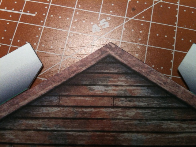

I printed and cut one of the tumbleweed pages you mentioned.

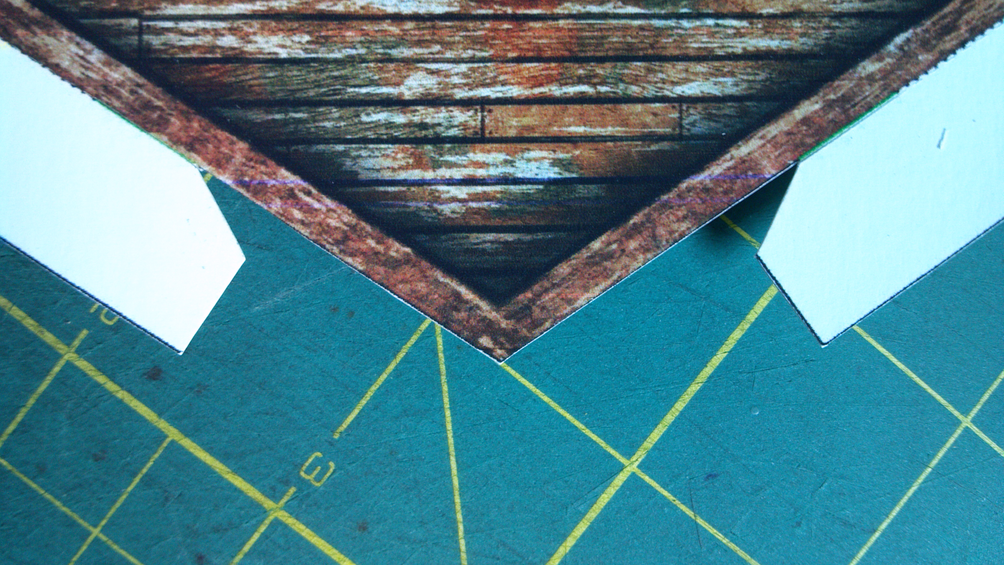

I tried this morning making a new cut file for a slightly different type of broken wall, and I had the exact same issue with the cut lines not lining up. Are you running the latest Studio version? I just don't know what I'm doing wrong!!!
Thanks. I PM'ed you a link - if it's not too much trouble, can you try a similar page from my PDF? If it 'just works' then I won't let this get in the way of me packaging up the project. If it doesn't work, then I'll pull the brakes on production while I sort out my issue.
Thanks oldschooldm. I installed 2.7.3, but still no change in behavior.

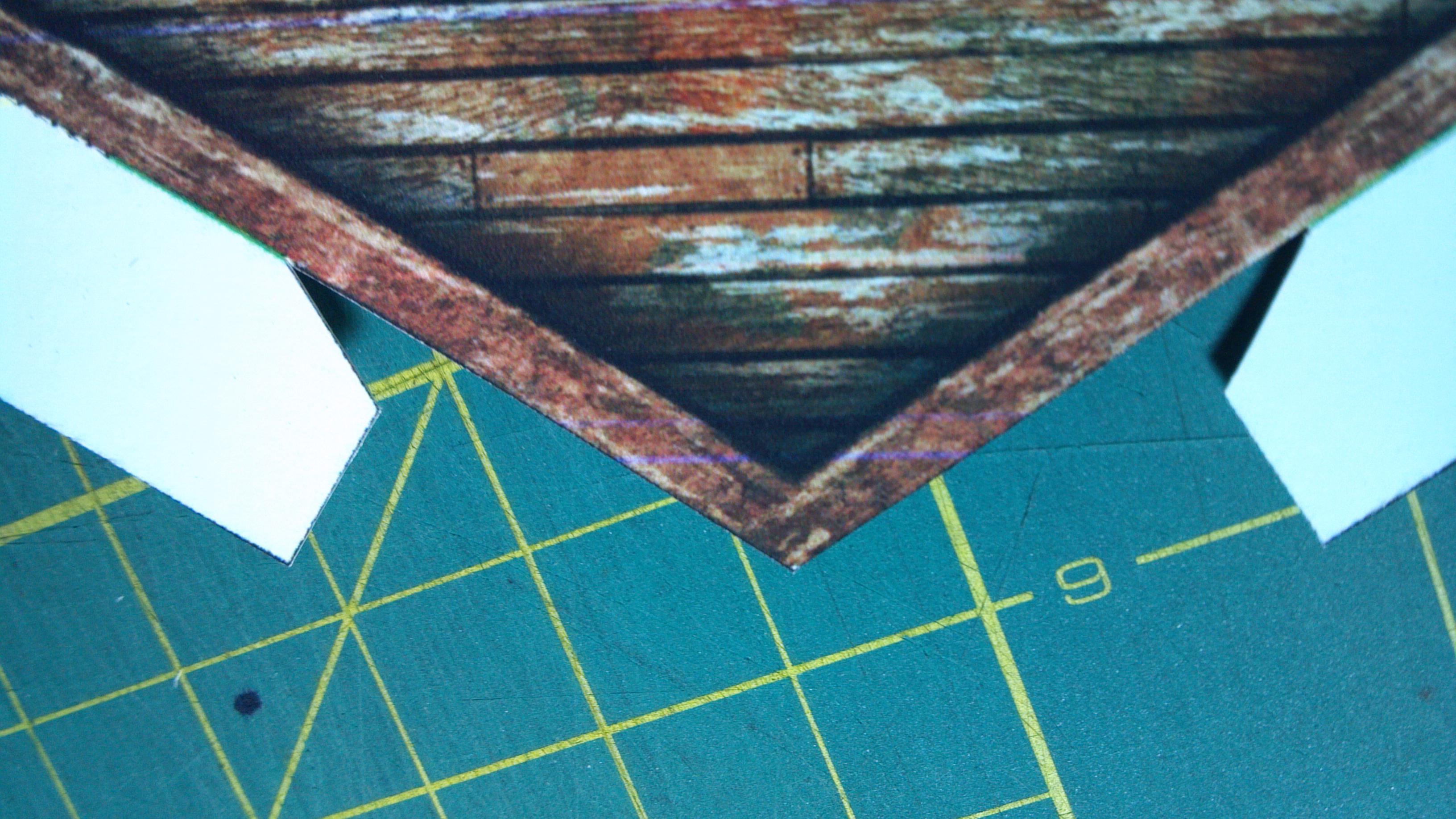

Walls cut with the "6InchWalls1" line up perfectly. The kind of accuracy that makes you so happy you bought one of these things. "6InchWalls2" still doesn't line up. I tried the files straight out of the DeadFalls zip file, and here's what I'm talking about:
[phpBB Debug] PHP Warning: in file /includes/functions_reimg.php on line 122: preg_match_all(): The /e modifier is no longer supported, use preg_replace_callback instead [phpBB Debug] PHP Warning: in file /includes/functions_reimg.php on line 124: array_unique() expects parameter 1 to be array, null given [phpBB Debug] PHP Warning: in file /includes/functions_reimg.php on line 126: Invalid argument supplied for foreach() [phpBB Debug] PHP Warning: in file /includes/functions_reimg.php on line 122: preg_match_all(): The /e modifier is no longer supported, use preg_replace_callback instead [phpBB Debug] PHP Warning: in file /includes/functions_reimg.php on line 124: array_unique() expects parameter 1 to be array, null given [phpBB Debug] PHP Warning: in file /includes/functions_reimg.php on line 126: Invalid argument supplied for foreach() [phpBB Debug] PHP Warning: in file /includes/functions_reimg.php on line 122: preg_match_all(): The /e modifier is no longer supported, use preg_replace_callback instead [phpBB Debug] PHP Warning: in file /includes/functions_reimg.php on line 124: array_unique() expects parameter 1 to be array, null given [phpBB Debug] PHP Warning: in file /includes/functions_reimg.php on line 126: Invalid argument supplied for foreach() [phpBB Debug] PHP Warning: in file /includes/functions_reimg.php on line 122: preg_match_all(): The /e modifier is no longer supported, use preg_replace_callback instead [phpBB Debug] PHP Warning: in file /includes/functions_reimg.php on line 124: array_unique() expects parameter 1 to be array, null given [phpBB Debug] PHP Warning: in file /includes/functions_reimg.php on line 126: Invalid argument supplied for foreach() [phpBB Debug] PHP Warning: in file /includes/functions_reimg.php on line 122: preg_match_all(): The /e modifier is no longer supported, use preg_replace_callback instead [phpBB Debug] PHP Warning: in file /includes/functions_reimg.php on line 124: array_unique() expects parameter 1 to be array, null given [phpBB Debug] PHP Warning: in file /includes/functions_reimg.php on line 126: Invalid argument supplied for foreach() [phpBB Debug] PHP Warning: in file /includes/functions_reimg.php on line 122: preg_match_all(): The /e modifier is no longer supported, use preg_replace_callback instead [phpBB Debug] PHP Warning: in file /includes/functions_reimg.php on line 124: array_unique() expects parameter 1 to be array, null given [phpBB Debug] PHP Warning: in file /includes/functions_reimg.php on line 126: Invalid argument supplied for foreach() [phpBB Debug] PHP Warning: in file /includes/functions_reimg.php on line 122: preg_match_all(): The /e modifier is no longer supported, use preg_replace_callback instead [phpBB Debug] PHP Warning: in file /includes/functions_reimg.php on line 124: array_unique() expects parameter 1 to be array, null given [phpBB Debug] PHP Warning: in file /includes/functions_reimg.php on line 126: Invalid argument supplied for foreach() [phpBB Debug] PHP Warning: in file /includes/functions_reimg.php on line 122: preg_match_all(): The /e modifier is no longer supported, use preg_replace_callback instead [phpBB Debug] PHP Warning: in file /includes/functions_reimg.php on line 124: array_unique() expects parameter 1 to be array, null given [phpBB Debug] PHP Warning: in file /includes/functions_reimg.php on line 126: Invalid argument supplied for foreach() [phpBB Debug] PHP Warning: in file /includes/functions_reimg.php on line 122: preg_match_all(): The /e modifier is no longer supported, use preg_replace_callback instead [phpBB Debug] PHP Warning: in file /includes/functions_reimg.php on line 124: array_unique() expects parameter 1 to be array, null given [phpBB Debug] PHP Warning: in file /includes/functions_reimg.php on line 126: Invalid argument supplied for foreach() [phpBB Debug] PHP Warning: in file /includes/functions_reimg.php on line 122: preg_match_all(): The /e modifier is no longer supported, use preg_replace_callback instead [phpBB Debug] PHP Warning: in file /includes/functions_reimg.php on line 124: array_unique() expects parameter 1 to be array, null given [phpBB Debug] PHP Warning: in file /includes/functions_reimg.php on line 126: Invalid argument supplied for foreach() [phpBB Debug] PHP Warning: in file /includes/functions_reimg.php on line 122: preg_match_all(): The /e modifier is no longer supported, use preg_replace_callback instead [phpBB Debug] PHP Warning: in file /includes/functions_reimg.php on line 124: array_unique() expects parameter 1 to be array, null given [phpBB Debug] PHP Warning: in file /includes/functions_reimg.php on line 126: Invalid argument supplied for foreach() [phpBB Debug] PHP Warning: in file /includes/functions_reimg.php on line 122: preg_match_all(): The /e modifier is no longer supported, use preg_replace_callback instead [phpBB Debug] PHP Warning: in file /includes/functions_reimg.php on line 124: array_unique() expects parameter 1 to be array, null given [phpBB Debug] PHP Warning: in file /includes/functions_reimg.php on line 126: Invalid argument supplied for foreach() [phpBB Debug] PHP Warning: in file /includes/functions_reimg.php on line 122: preg_match_all(): The /e modifier is no longer supported, use preg_replace_callback instead [phpBB Debug] PHP Warning: in file /includes/functions_reimg.php on line 124: array_unique() expects parameter 1 to be array, null given [phpBB Debug] PHP Warning: in file /includes/functions_reimg.php on line 126: Invalid argument supplied for foreach() [phpBB Debug] PHP Warning: in file /includes/functions_reimg.php on line 122: preg_match_all(): The /e modifier is no longer supported, use preg_replace_callback instead [phpBB Debug] PHP Warning: in file /includes/functions_reimg.php on line 124: array_unique() expects parameter 1 to be array, null given [phpBB Debug] PHP Warning: in file /includes/functions_reimg.php on line 126: Invalid argument supplied for foreach() [phpBB Debug] PHP Warning: in file /includes/functions_reimg.php on line 122: preg_match_all(): The /e modifier is no longer supported, use preg_replace_callback instead [phpBB Debug] PHP Warning: in file /includes/functions_reimg.php on line 124: array_unique() expects parameter 1 to be array, null given [phpBB Debug] PHP Warning: in file /includes/functions_reimg.php on line 126: Invalid argument supplied for foreach() [phpBB Debug] PHP Warning: in file /includes/functions_reimg.php on line 122: preg_match_all(): The /e modifier is no longer supported, use preg_replace_callback instead [phpBB Debug] PHP Warning: in file /includes/functions_reimg.php on line 124: array_unique() expects parameter 1 to be array, null given [phpBB Debug] PHP Warning: in file /includes/functions_reimg.php on line 126: Invalid argument supplied for foreach() [phpBB Debug] PHP Warning: in file /includes/functions_reimg.php on line 122: preg_match_all(): The /e modifier is no longer supported, use preg_replace_callback instead [phpBB Debug] PHP Warning: in file /includes/functions_reimg.php on line 124: array_unique() expects parameter 1 to be array, null given [phpBB Debug] PHP Warning: in file /includes/functions_reimg.php on line 126: Invalid argument supplied for foreach() [phpBB Debug] PHP Warning: in file /includes/functions_reimg.php on line 122: preg_match_all(): The /e modifier is no longer supported, use preg_replace_callback instead [phpBB Debug] PHP Warning: in file /includes/functions_reimg.php on line 124: array_unique() expects parameter 1 to be array, null given [phpBB Debug] PHP Warning: in file /includes/functions_reimg.php on line 126: Invalid argument supplied for foreach() [phpBB Debug] PHP Warning: in file /includes/functions_reimg.php on line 122: preg_match_all(): The /e modifier is no longer supported, use preg_replace_callback instead [phpBB Debug] PHP Warning: in file /includes/functions_reimg.php on line 124: array_unique() expects parameter 1 to be array, null given [phpBB Debug] PHP Warning: in file /includes/functions_reimg.php on line 126: Invalid argument supplied for foreach() [phpBB Debug] PHP Warning: in file /includes/functions_reimg.php on line 122: preg_match_all(): The /e modifier is no longer supported, use preg_replace_callback instead [phpBB Debug] PHP Warning: in file /includes/functions_reimg.php on line 124: array_unique() expects parameter 1 to be array, null given [phpBB Debug] PHP Warning: in file /includes/functions_reimg.php on line 126: Invalid argument supplied for foreach() [phpBB Debug] PHP Warning: in file /includes/functions_reimg.php on line 122: preg_match_all(): The /e modifier is no longer supported, use preg_replace_callback instead [phpBB Debug] PHP Warning: in file /includes/functions_reimg.php on line 124: array_unique() expects parameter 1 to be array, null given [phpBB Debug] PHP Warning: in file /includes/functions_reimg.php on line 126: Invalid argument supplied for foreach() [phpBB Debug] PHP Warning: in file /includes/functions_reimg.php on line 122: preg_match_all(): The /e modifier is no longer supported, use preg_replace_callback instead [phpBB Debug] PHP Warning: in file /includes/functions_reimg.php on line 124: array_unique() expects parameter 1 to be array, null given [phpBB Debug] PHP Warning: in file /includes/functions_reimg.php on line 126: Invalid argument supplied for foreach() [phpBB Debug] PHP Warning: in file /includes/functions_reimg.php on line 122: preg_match_all(): The /e modifier is no longer supported, use preg_replace_callback instead [phpBB Debug] PHP Warning: in file /includes/functions_reimg.php on line 124: array_unique() expects parameter 1 to be array, null given [phpBB Debug] PHP Warning: in file /includes/functions_reimg.php on line 126: Invalid argument supplied for foreach() [phpBB Debug] PHP Warning: in file /includes/functions_reimg.php on line 122: preg_match_all(): The /e modifier is no longer supported, use preg_replace_callback instead [phpBB Debug] PHP Warning: in file /includes/functions_reimg.php on line 124: array_unique() expects parameter 1 to be array, null given [phpBB Debug] PHP Warning: in file /includes/functions_reimg.php on line 126: Invalid argument supplied for foreach() [phpBB Debug] PHP Warning: in file /includes/functions_reimg.php on line 122: preg_match_all(): The /e modifier is no longer supported, use preg_replace_callback instead [phpBB Debug] PHP Warning: in file /includes/functions_reimg.php on line 124: array_unique() expects parameter 1 to be array, null given [phpBB Debug] PHP Warning: in file /includes/functions_reimg.php on line 126: Invalid argument supplied for foreach() [phpBB Debug] PHP Warning: in file /includes/functions_reimg.php on line 122: preg_match_all(): The /e modifier is no longer supported, use preg_replace_callback instead [phpBB Debug] PHP Warning: in file /includes/functions_reimg.php on line 124: array_unique() expects parameter 1 to be array, null given [phpBB Debug] PHP Warning: in file /includes/functions_reimg.php on line 126: Invalid argument supplied for foreach() [phpBB Debug] PHP Warning: in file /includes/functions_reimg.php on line 122: preg_match_all(): The /e modifier is no longer supported, use preg_replace_callback instead [phpBB Debug] PHP Warning: in file /includes/functions_reimg.php on line 124: array_unique() expects parameter 1 to be array, null given [phpBB Debug] PHP Warning: in file /includes/functions_reimg.php on line 126: Invalid argument supplied for foreach() [phpBB Debug] PHP Warning: in file /includes/functions_reimg.php on line 122: preg_match_all(): The /e modifier is no longer supported, use preg_replace_callback instead [phpBB Debug] PHP Warning: in file /includes/functions_reimg.php on line 124: array_unique() expects parameter 1 to be array, null given [phpBB Debug] PHP Warning: in file /includes/functions_reimg.php on line 126: Invalid argument supplied for foreach() [phpBB Debug] PHP Warning: in file /includes/functions_reimg.php on line 122: preg_match_all(): The /e modifier is no longer supported, use preg_replace_callback instead [phpBB Debug] PHP Warning: in file /includes/functions_reimg.php on line 124: array_unique() expects parameter 1 to be array, null given [phpBB Debug] PHP Warning: in file /includes/functions_reimg.php on line 126: Invalid argument supplied for foreach() [phpBB Debug] PHP Warning: in file /includes/functions_reimg.php on line 122: preg_match_all(): The /e modifier is no longer supported, use preg_replace_callback instead [phpBB Debug] PHP Warning: in file /includes/functions_reimg.php on line 124: array_unique() expects parameter 1 to be array, null given [phpBB Debug] PHP Warning: in file /includes/functions_reimg.php on line 126: Invalid argument supplied for foreach() [phpBB Debug] PHP Warning: in file /includes/functions_reimg.php on line 122: preg_match_all(): The /e modifier is no longer supported, use preg_replace_callback instead [phpBB Debug] PHP Warning: in file /includes/functions_reimg.php on line 124: array_unique() expects parameter 1 to be array, null given [phpBB Debug] PHP Warning: in file /includes/functions_reimg.php on line 126: Invalid argument supplied for foreach() [phpBB Debug] PHP Warning: in file /includes/functions_reimg.php on line 122: preg_match_all(): The /e modifier is no longer supported, use preg_replace_callback instead [phpBB Debug] PHP Warning: in file /includes/functions_reimg.php on line 124: array_unique() expects parameter 1 to be array, null given [phpBB Debug] PHP Warning: in file /includes/functions_reimg.php on line 126: Invalid argument supplied for foreach() [phpBB Debug] PHP Warning: in file /includes/functions_reimg.php on line 122: preg_match_all(): The /e modifier is no longer supported, use preg_replace_callback instead [phpBB Debug] PHP Warning: in file /includes/functions_reimg.php on line 124: array_unique() expects parameter 1 to be array, null given [phpBB Debug] PHP Warning: in file /includes/functions_reimg.php on line 126: Invalid argument supplied for foreach() [phpBB Debug] PHP Warning: in file /includes/functions_reimg.php on line 122: preg_match_all(): The /e modifier is no longer supported, use preg_replace_callback instead [phpBB Debug] PHP Warning: in file /includes/functions_reimg.php on line 124: array_unique() expects parameter 1 to be array, null given [phpBB Debug] PHP Warning: in file /includes/functions_reimg.php on line 126: Invalid argument supplied for foreach() [phpBB Debug] PHP Warning: in file /includes/functions_reimg.php on line 122: preg_match_all(): The /e modifier is no longer supported, use preg_replace_callback instead [phpBB Debug] PHP Warning: in file /includes/functions_reimg.php on line 124: array_unique() expects parameter 1 to be array, null given [phpBB Debug] PHP Warning: in file /includes/functions_reimg.php on line 126: Invalid argument supplied for foreach() [phpBB Debug] PHP Warning: in file /includes/functions_reimg.php on line 122: preg_match_all(): The /e modifier is no longer supported, use preg_replace_callback instead [phpBB Debug] PHP Warning: in file /includes/functions_reimg.php on line 124: array_unique() expects parameter 1 to be array, null given [phpBB Debug] PHP Warning: in file /includes/functions_reimg.php on line 126: Invalid argument supplied for foreach() [phpBB Debug] PHP Warning: in file /includes/functions_reimg.php on line 122: preg_match_all(): The /e modifier is no longer supported, use preg_replace_callback instead [phpBB Debug] PHP Warning: in file /includes/functions_reimg.php on line 124: array_unique() expects parameter 1 to be array, null given [phpBB Debug] PHP Warning: in file /includes/functions_reimg.php on line 126: Invalid argument supplied for foreach() [phpBB Debug] PHP Warning: in file /includes/functions_reimg.php on line 122: preg_match_all(): The /e modifier is no longer supported, use preg_replace_callback instead [phpBB Debug] PHP Warning: in file /includes/functions_reimg.php on line 124: array_unique() expects parameter 1 to be array, null given [phpBB Debug] PHP Warning: in file /includes/functions_reimg.php on line 126: Invalid argument supplied for foreach() [phpBB Debug] PHP Warning: in file /includes/functions_reimg.php on line 122: preg_match_all(): The /e modifier is no longer supported, use preg_replace_callback instead [phpBB Debug] PHP Warning: in file /includes/functions_reimg.php on line 124: array_unique() expects parameter 1 to be array, null given [phpBB Debug] PHP Warning: in file /includes/functions_reimg.php on line 126: Invalid argument supplied for foreach() [phpBB Debug] PHP Warning: in file /includes/functions_reimg.php on line 122: preg_match_all(): The /e modifier is no longer supported, use preg_replace_callback instead [phpBB Debug] PHP Warning: in file /includes/functions_reimg.php on line 124: array_unique() expects parameter 1 to be array, null given [phpBB Debug] PHP Warning: in file /includes/functions_reimg.php on line 126: Invalid argument supplied for foreach() [phpBB Debug] PHP Warning: in file /includes/functions_reimg.php on line 122: preg_match_all(): The /e modifier is no longer supported, use preg_replace_callback instead [phpBB Debug] PHP Warning: in file /includes/functions_reimg.php on line 124: array_unique() expects parameter 1 to be array, null given [phpBB Debug] PHP Warning: in file /includes/functions_reimg.php on line 126: Invalid argument supplied for foreach() [phpBB Debug] PHP Warning: in file /includes/functions_reimg.php on line 122: preg_match_all(): The /e modifier is no longer supported, use preg_replace_callback instead [phpBB Debug] PHP Warning: in file /includes/functions_reimg.php on line 124: array_unique() expects parameter 1 to be array, null given [phpBB Debug] PHP Warning: in file /includes/functions_reimg.php on line 126: Invalid argument supplied for foreach() [phpBB Debug] PHP Warning: in file /includes/functions_reimg.php on line 122: preg_match_all(): The /e modifier is no longer supported, use preg_replace_callback instead [phpBB Debug] PHP Warning: in file /includes/functions_reimg.php on line 124: array_unique() expects parameter 1 to be array, null given [phpBB Debug] PHP Warning: in file /includes/functions_reimg.php on line 126: Invalid argument supplied for foreach() [phpBB Debug] PHP Warning: in file /includes/functions_reimg.php on line 122: preg_match_all(): The /e modifier is no longer supported, use preg_replace_callback instead [phpBB Debug] PHP Warning: in file /includes/functions_reimg.php on line 124: array_unique() expects parameter 1 to be array, null given [phpBB Debug] PHP Warning: in file /includes/functions_reimg.php on line 126: Invalid argument supplied for foreach() [phpBB Debug] PHP Warning: in file /includes/functions_reimg.php on line 122: preg_match_all(): The /e modifier is no longer supported, use preg_replace_callback instead [phpBB Debug] PHP Warning: in file /includes/functions_reimg.php on line 124: array_unique() expects parameter 1 to be array, null given [phpBB Debug] PHP Warning: in file /includes/functions_reimg.php on line 126: Invalid argument supplied for foreach() [phpBB Debug] PHP Warning: in file /includes/functions_reimg.php on line 122: preg_match_all(): The /e modifier is no longer supported, use preg_replace_callback instead [phpBB Debug] PHP Warning: in file /includes/functions_reimg.php on line 124: array_unique() expects parameter 1 to be array, null given [phpBB Debug] PHP Warning: in file /includes/functions_reimg.php on line 126: Invalid argument supplied for foreach() [phpBB Debug] PHP Warning: in file /includes/functions_reimg.php on line 122: preg_match_all(): The /e modifier is no longer supported, use preg_replace_callback instead [phpBB Debug] PHP Warning: in file /includes/functions_reimg.php on line 124: array_unique() expects parameter 1 to be array, null given [phpBB Debug] PHP Warning: in file /includes/functions_reimg.php on line 126: Invalid argument supplied for foreach() [phpBB Debug] PHP Warning: in file /includes/functions_reimg.php on line 122: preg_match_all(): The /e modifier is no longer supported, use preg_replace_callback instead [phpBB Debug] PHP Warning: in file /includes/functions_reimg.php on line 124: array_unique() expects parameter 1 to be array, null given [phpBB Debug] PHP Warning: in file /includes/functions_reimg.php on line 126: Invalid argument supplied for foreach() [phpBB Debug] PHP Warning: in file /includes/functions_reimg.php on line 122: preg_match_all(): The /e modifier is no longer supported, use preg_replace_callback instead [phpBB Debug] PHP Warning: in file /includes/functions_reimg.php on line 124: array_unique() expects parameter 1 to be array, null given [phpBB Debug] PHP Warning: in file /includes/functions_reimg.php on line 126: Invalid argument supplied for foreach() [phpBB Debug] PHP Warning: in file /includes/functions_reimg.php on line 122: preg_match_all(): The /e modifier is no longer supported, use preg_replace_callback instead [phpBB Debug] PHP Warning: in file /includes/functions_reimg.php on line 124: array_unique() expects parameter 1 to be array, null given [phpBB Debug] PHP Warning: in file /includes/functions_reimg.php on line 126: Invalid argument supplied for foreach() [phpBB Debug] PHP Warning: in file /includes/functions_reimg.php on line 122: preg_match_all(): The /e modifier is no longer supported, use preg_replace_callback instead [phpBB Debug] PHP Warning: in file /includes/functions_reimg.php on line 124: array_unique() expects parameter 1 to be array, null given [phpBB Debug] PHP Warning: in file /includes/functions_reimg.php on line 126: Invalid argument supplied for foreach() [phpBB Debug] PHP Warning: in file /includes/functions_reimg.php on line 122: preg_match_all(): The /e modifier is no longer supported, use preg_replace_callback instead [phpBB Debug] PHP Warning: in file /includes/functions_reimg.php on line 124: array_unique() expects parameter 1 to be array, null given [phpBB Debug] PHP Warning: in file /includes/functions_reimg.php on line 126: Invalid argument supplied for foreach() [phpBB Debug] PHP Warning: in file /includes/functions_reimg.php on line 122: preg_match_all(): The /e modifier is no longer supported, use preg_replace_callback instead [phpBB Debug] PHP Warning: in file /includes/functions_reimg.php on line 124: array_unique() expects parameter 1 to be array, null given [phpBB Debug] PHP Warning: in file /includes/functions_reimg.php on line 126: Invalid argument supplied for foreach() [phpBB Debug] PHP Warning: in file /includes/functions_reimg.php on line 122: preg_match_all(): The /e modifier is no longer supported, use preg_replace_callback instead [phpBB Debug] PHP Warning: in file /includes/functions_reimg.php on line 124: array_unique() expects parameter 1 to be array, null given [phpBB Debug] PHP Warning: in file /includes/functions_reimg.php on line 126: Invalid argument supplied for foreach() [phpBB Debug] PHP Warning: in file /includes/functions_reimg.php on line 122: preg_match_all(): The /e modifier is no longer supported, use preg_replace_callback instead [phpBB Debug] PHP Warning: in file /includes/functions_reimg.php on line 124: array_unique() expects parameter 1 to be array, null given [phpBB Debug] PHP Warning: in file /includes/functions_reimg.php on line 126: Invalid argument supplied for foreach() [phpBB Debug] PHP Warning: in file /includes/functions_reimg.php on line 122: preg_match_all(): The /e modifier is no longer supported, use preg_replace_callback instead [phpBB Debug] PHP Warning: in file /includes/functions_reimg.php on line 124: array_unique() expects parameter 1 to be array, null given [phpBB Debug] PHP Warning: in file /includes/functions_reimg.php on line 126: Invalid argument supplied for foreach() [phpBB Debug] PHP Warning: in file /includes/functions_reimg.php on line 122: preg_match_all(): The /e modifier is no longer supported, use preg_replace_callback instead [phpBB Debug] PHP Warning: in file /includes/functions_reimg.php on line 124: array_unique() expects parameter 1 to be array, null given [phpBB Debug] PHP Warning: in file /includes/functions_reimg.php on line 126: Invalid argument supplied for foreach() [phpBB Debug] PHP Warning: in file /includes/functions_reimg.php on line 122: preg_match_all(): The /e modifier is no longer supported, use preg_replace_callback instead [phpBB Debug] PHP Warning: in file /includes/functions_reimg.php on line 124: array_unique() expects parameter 1 to be array, null given [phpBB Debug] PHP Warning: in file /includes/functions_reimg.php on line 126: Invalid argument supplied for foreach() pic2.JPG [ 159.03 KiB | Viewed 65358 times ]
Now, the other wall that gets cut out is lined up great at the top:
[phpBB Debug] PHP Warning: in file /includes/functions_reimg.php on line 122: preg_match_all(): The /e modifier is no longer supported, use preg_replace_callback instead [phpBB Debug] PHP Warning: in file /includes/functions_reimg.php on line 124: array_unique() expects parameter 1 to be array, null given [phpBB Debug] PHP Warning: in file /includes/functions_reimg.php on line 126: Invalid argument supplied for foreach() [phpBB Debug] PHP Warning: in file /includes/functions_reimg.php on line 122: preg_match_all(): The /e modifier is no longer supported, use preg_replace_callback instead [phpBB Debug] PHP Warning: in file /includes/functions_reimg.php on line 124: array_unique() expects parameter 1 to be array, null given [phpBB Debug] PHP Warning: in file /includes/functions_reimg.php on line 126: Invalid argument supplied for foreach() [phpBB Debug] PHP Warning: in file /includes/functions_reimg.php on line 122: preg_match_all(): The /e modifier is no longer supported, use preg_replace_callback instead [phpBB Debug] PHP Warning: in file /includes/functions_reimg.php on line 124: array_unique() expects parameter 1 to be array, null given [phpBB Debug] PHP Warning: in file /includes/functions_reimg.php on line 126: Invalid argument supplied for foreach() [phpBB Debug] PHP Warning: in file /includes/functions_reimg.php on line 122: preg_match_all(): The /e modifier is no longer supported, use preg_replace_callback instead [phpBB Debug] PHP Warning: in file /includes/functions_reimg.php on line 124: array_unique() expects parameter 1 to be array, null given [phpBB Debug] PHP Warning: in file /includes/functions_reimg.php on line 126: Invalid argument supplied for foreach() [phpBB Debug] PHP Warning: in file /includes/functions_reimg.php on line 122: preg_match_all(): The /e modifier is no longer supported, use preg_replace_callback instead [phpBB Debug] PHP Warning: in file /includes/functions_reimg.php on line 124: array_unique() expects parameter 1 to be array, null given [phpBB Debug] PHP Warning: in file /includes/functions_reimg.php on line 126: Invalid argument supplied for foreach() [phpBB Debug] PHP Warning: in file /includes/functions_reimg.php on line 122: preg_match_all(): The /e modifier is no longer supported, use preg_replace_callback instead [phpBB Debug] PHP Warning: in file /includes/functions_reimg.php on line 124: array_unique() expects parameter 1 to be array, null given [phpBB Debug] PHP Warning: in file /includes/functions_reimg.php on line 126: Invalid argument supplied for foreach() [phpBB Debug] PHP Warning: in file /includes/functions_reimg.php on line 122: preg_match_all(): The /e modifier is no longer supported, use preg_replace_callback instead [phpBB Debug] PHP Warning: in file /includes/functions_reimg.php on line 124: array_unique() expects parameter 1 to be array, null given [phpBB Debug] PHP Warning: in file /includes/functions_reimg.php on line 126: Invalid argument supplied for foreach() [phpBB Debug] PHP Warning: in file /includes/functions_reimg.php on line 122: preg_match_all(): The /e modifier is no longer supported, use preg_replace_callback instead [phpBB Debug] PHP Warning: in file /includes/functions_reimg.php on line 124: array_unique() expects parameter 1 to be array, null given [phpBB Debug] PHP Warning: in file /includes/functions_reimg.php on line 126: Invalid argument supplied for foreach() [phpBB Debug] PHP Warning: in file /includes/functions_reimg.php on line 122: preg_match_all(): The /e modifier is no longer supported, use preg_replace_callback instead [phpBB Debug] PHP Warning: in file /includes/functions_reimg.php on line 124: array_unique() expects parameter 1 to be array, null given [phpBB Debug] PHP Warning: in file /includes/functions_reimg.php on line 126: Invalid argument supplied for foreach() [phpBB Debug] PHP Warning: in file /includes/functions_reimg.php on line 122: preg_match_all(): The /e modifier is no longer supported, use preg_replace_callback instead [phpBB Debug] PHP Warning: in file /includes/functions_reimg.php on line 124: array_unique() expects parameter 1 to be array, null given [phpBB Debug] PHP Warning: in file /includes/functions_reimg.php on line 126: Invalid argument supplied for foreach() [phpBB Debug] PHP Warning: in file /includes/functions_reimg.php on line 122: preg_match_all(): The /e modifier is no longer supported, use preg_replace_callback instead [phpBB Debug] PHP Warning: in file /includes/functions_reimg.php on line 124: array_unique() expects parameter 1 to be array, null given [phpBB Debug] PHP Warning: in file /includes/functions_reimg.php on line 126: Invalid argument supplied for foreach() [phpBB Debug] PHP Warning: in file /includes/functions_reimg.php on line 122: preg_match_all(): The /e modifier is no longer supported, use preg_replace_callback instead [phpBB Debug] PHP Warning: in file /includes/functions_reimg.php on line 124: array_unique() expects parameter 1 to be array, null given [phpBB Debug] PHP Warning: in file /includes/functions_reimg.php on line 126: Invalid argument supplied for foreach() [phpBB Debug] PHP Warning: in file /includes/functions_reimg.php on line 122: preg_match_all(): The /e modifier is no longer supported, use preg_replace_callback instead [phpBB Debug] PHP Warning: in file /includes/functions_reimg.php on line 124: array_unique() expects parameter 1 to be array, null given [phpBB Debug] PHP Warning: in file /includes/functions_reimg.php on line 126: Invalid argument supplied for foreach() [phpBB Debug] PHP Warning: in file /includes/functions_reimg.php on line 122: preg_match_all(): The /e modifier is no longer supported, use preg_replace_callback instead [phpBB Debug] PHP Warning: in file /includes/functions_reimg.php on line 124: array_unique() expects parameter 1 to be array, null given [phpBB Debug] PHP Warning: in file /includes/functions_reimg.php on line 126: Invalid argument supplied for foreach() [phpBB Debug] PHP Warning: in file /includes/functions_reimg.php on line 122: preg_match_all(): The /e modifier is no longer supported, use preg_replace_callback instead [phpBB Debug] PHP Warning: in file /includes/functions_reimg.php on line 124: array_unique() expects parameter 1 to be array, null given [phpBB Debug] PHP Warning: in file /includes/functions_reimg.php on line 126: Invalid argument supplied for foreach() [phpBB Debug] PHP Warning: in file /includes/functions_reimg.php on line 122: preg_match_all(): The /e modifier is no longer supported, use preg_replace_callback instead [phpBB Debug] PHP Warning: in file /includes/functions_reimg.php on line 124: array_unique() expects parameter 1 to be array, null given [phpBB Debug] PHP Warning: in file /includes/functions_reimg.php on line 126: Invalid argument supplied for foreach() [phpBB Debug] PHP Warning: in file /includes/functions_reimg.php on line 122: preg_match_all(): The /e modifier is no longer supported, use preg_replace_callback instead [phpBB Debug] PHP Warning: in file /includes/functions_reimg.php on line 124: array_unique() expects parameter 1 to be array, null given [phpBB Debug] PHP Warning: in file /includes/functions_reimg.php on line 126: Invalid argument supplied for foreach() [phpBB Debug] PHP Warning: in file /includes/functions_reimg.php on line 122: preg_match_all(): The /e modifier is no longer supported, use preg_replace_callback instead [phpBB Debug] PHP Warning: in file /includes/functions_reimg.php on line 124: array_unique() expects parameter 1 to be array, null given [phpBB Debug] PHP Warning: in file /includes/functions_reimg.php on line 126: Invalid argument supplied for foreach() [phpBB Debug] PHP Warning: in file /includes/functions_reimg.php on line 122: preg_match_all(): The /e modifier is no longer supported, use preg_replace_callback instead [phpBB Debug] PHP Warning: in file /includes/functions_reimg.php on line 124: array_unique() expects parameter 1 to be array, null given [phpBB Debug] PHP Warning: in file /includes/functions_reimg.php on line 126: Invalid argument supplied for foreach() [phpBB Debug] PHP Warning: in file /includes/functions_reimg.php on line 122: preg_match_all(): The /e modifier is no longer supported, use preg_replace_callback instead [phpBB Debug] PHP Warning: in file /includes/functions_reimg.php on line 124: array_unique() expects parameter 1 to be array, null given [phpBB Debug] PHP Warning: in file /includes/functions_reimg.php on line 126: Invalid argument supplied for foreach() [phpBB Debug] PHP Warning: in file /includes/functions_reimg.php on line 122: preg_match_all(): The /e modifier is no longer supported, use preg_replace_callback instead [phpBB Debug] PHP Warning: in file /includes/functions_reimg.php on line 124: array_unique() expects parameter 1 to be array, null given [phpBB Debug] PHP Warning: in file /includes/functions_reimg.php on line 126: Invalid argument supplied for foreach() [phpBB Debug] PHP Warning: in file /includes/functions_reimg.php on line 122: preg_match_all(): The /e modifier is no longer supported, use preg_replace_callback instead [phpBB Debug] PHP Warning: in file /includes/functions_reimg.php on line 124: array_unique() expects parameter 1 to be array, null given [phpBB Debug] PHP Warning: in file /includes/functions_reimg.php on line 126: Invalid argument supplied for foreach() [phpBB Debug] PHP Warning: in file /includes/functions_reimg.php on line 122: preg_match_all(): The /e modifier is no longer supported, use preg_replace_callback instead [phpBB Debug] PHP Warning: in file /includes/functions_reimg.php on line 124: array_unique() expects parameter 1 to be array, null given [phpBB Debug] PHP Warning: in file /includes/functions_reimg.php on line 126: Invalid argument supplied for foreach() [phpBB Debug] PHP Warning: in file /includes/functions_reimg.php on line 122: preg_match_all(): The /e modifier is no longer supported, use preg_replace_callback instead [phpBB Debug] PHP Warning: in file /includes/functions_reimg.php on line 124: array_unique() expects parameter 1 to be array, null given [phpBB Debug] PHP Warning: in file /includes/functions_reimg.php on line 126: Invalid argument supplied for foreach() [phpBB Debug] PHP Warning: in file /includes/functions_reimg.php on line 122: preg_match_all(): The /e modifier is no longer supported, use preg_replace_callback instead [phpBB Debug] PHP Warning: in file /includes/functions_reimg.php on line 124: array_unique() expects parameter 1 to be array, null given [phpBB Debug] PHP Warning: in file /includes/functions_reimg.php on line 126: Invalid argument supplied for foreach() [phpBB Debug] PHP Warning: in file /includes/functions_reimg.php on line 122: preg_match_all(): The /e modifier is no longer supported, use preg_replace_callback instead [phpBB Debug] PHP Warning: in file /includes/functions_reimg.php on line 124: array_unique() expects parameter 1 to be array, null given [phpBB Debug] PHP Warning: in file /includes/functions_reimg.php on line 126: Invalid argument supplied for foreach() [phpBB Debug] PHP Warning: in file /includes/functions_reimg.php on line 122: preg_match_all(): The /e modifier is no longer supported, use preg_replace_callback instead [phpBB Debug] PHP Warning: in file /includes/functions_reimg.php on line 124: array_unique() expects parameter 1 to be array, null given [phpBB Debug] PHP Warning: in file /includes/functions_reimg.php on line 126: Invalid argument supplied for foreach() [phpBB Debug] PHP Warning: in file /includes/functions_reimg.php on line 122: preg_match_all(): The /e modifier is no longer supported, use preg_replace_callback instead [phpBB Debug] PHP Warning: in file /includes/functions_reimg.php on line 124: array_unique() expects parameter 1 to be array, null given [phpBB Debug] PHP Warning: in file /includes/functions_reimg.php on line 126: Invalid argument supplied for foreach() [phpBB Debug] PHP Warning: in file /includes/functions_reimg.php on line 122: preg_match_all(): The /e modifier is no longer supported, use preg_replace_callback instead [phpBB Debug] PHP Warning: in file /includes/functions_reimg.php on line 124: array_unique() expects parameter 1 to be array, null given [phpBB Debug] PHP Warning: in file /includes/functions_reimg.php on line 126: Invalid argument supplied for foreach() [phpBB Debug] PHP Warning: in file /includes/functions_reimg.php on line 122: preg_match_all(): The /e modifier is no longer supported, use preg_replace_callback instead [phpBB Debug] PHP Warning: in file /includes/functions_reimg.php on line 124: array_unique() expects parameter 1 to be array, null given [phpBB Debug] PHP Warning: in file /includes/functions_reimg.php on line 126: Invalid argument supplied for foreach() [phpBB Debug] PHP Warning: in file /includes/functions_reimg.php on line 122: preg_match_all(): The /e modifier is no longer supported, use preg_replace_callback instead [phpBB Debug] PHP Warning: in file /includes/functions_reimg.php on line 124: array_unique() expects parameter 1 to be array, null given [phpBB Debug] PHP Warning: in file /includes/functions_reimg.php on line 126: Invalid argument supplied for foreach() [phpBB Debug] PHP Warning: in file /includes/functions_reimg.php on line 122: preg_match_all(): The /e modifier is no longer supported, use preg_replace_callback instead [phpBB Debug] PHP Warning: in file /includes/functions_reimg.php on line 124: array_unique() expects parameter 1 to be array, null given [phpBB Debug] PHP Warning: in file /includes/functions_reimg.php on line 126: Invalid argument supplied for foreach() [phpBB Debug] PHP Warning: in file /includes/functions_reimg.php on line 122: preg_match_all(): The /e modifier is no longer supported, use preg_replace_callback instead [phpBB Debug] PHP Warning: in file /includes/functions_reimg.php on line 124: array_unique() expects parameter 1 to be array, null given [phpBB Debug] PHP Warning: in file /includes/functions_reimg.php on line 126: Invalid argument supplied for foreach() [phpBB Debug] PHP Warning: in file /includes/functions_reimg.php on line 122: preg_match_all(): The /e modifier is no longer supported, use preg_replace_callback instead [phpBB Debug] PHP Warning: in file /includes/functions_reimg.php on line 124: array_unique() expects parameter 1 to be array, null given [phpBB Debug] PHP Warning: in file /includes/functions_reimg.php on line 126: Invalid argument supplied for foreach() [phpBB Debug] PHP Warning: in file /includes/functions_reimg.php on line 122: preg_match_all(): The /e modifier is no longer supported, use preg_replace_callback instead [phpBB Debug] PHP Warning: in file /includes/functions_reimg.php on line 124: array_unique() expects parameter 1 to be array, null given [phpBB Debug] PHP Warning: in file /includes/functions_reimg.php on line 126: Invalid argument supplied for foreach() [phpBB Debug] PHP Warning: in file /includes/functions_reimg.php on line 122: preg_match_all(): The /e modifier is no longer supported, use preg_replace_callback instead [phpBB Debug] PHP Warning: in file /includes/functions_reimg.php on line 124: array_unique() expects parameter 1 to be array, null given [phpBB Debug] PHP Warning: in file /includes/functions_reimg.php on line 126: Invalid argument supplied for foreach() [phpBB Debug] PHP Warning: in file /includes/functions_reimg.php on line 122: preg_match_all(): The /e modifier is no longer supported, use preg_replace_callback instead [phpBB Debug] PHP Warning: in file /includes/functions_reimg.php on line 124: array_unique() expects parameter 1 to be array, null given [phpBB Debug] PHP Warning: in file /includes/functions_reimg.php on line 126: Invalid argument supplied for foreach() [phpBB Debug] PHP Warning: in file /includes/functions_reimg.php on line 122: preg_match_all(): The /e modifier is no longer supported, use preg_replace_callback instead [phpBB Debug] PHP Warning: in file /includes/functions_reimg.php on line 124: array_unique() expects parameter 1 to be array, null given [phpBB Debug] PHP Warning: in file /includes/functions_reimg.php on line 126: Invalid argument supplied for foreach() [phpBB Debug] PHP Warning: in file /includes/functions_reimg.php on line 122: preg_match_all(): The /e modifier is no longer supported, use preg_replace_callback instead [phpBB Debug] PHP Warning: in file /includes/functions_reimg.php on line 124: array_unique() expects parameter 1 to be array, null given [phpBB Debug] PHP Warning: in file /includes/functions_reimg.php on line 126: Invalid argument supplied for foreach() [phpBB Debug] PHP Warning: in file /includes/functions_reimg.php on line 122: preg_match_all(): The /e modifier is no longer supported, use preg_replace_callback instead [phpBB Debug] PHP Warning: in file /includes/functions_reimg.php on line 124: array_unique() expects parameter 1 to be array, null given [phpBB Debug] PHP Warning: in file /includes/functions_reimg.php on line 126: Invalid argument supplied for foreach() [phpBB Debug] PHP Warning: in file /includes/functions_reimg.php on line 122: preg_match_all(): The /e modifier is no longer supported, use preg_replace_callback instead [phpBB Debug] PHP Warning: in file /includes/functions_reimg.php on line 124: array_unique() expects parameter 1 to be array, null given [phpBB Debug] PHP Warning: in file /includes/functions_reimg.php on line 126: Invalid argument supplied for foreach() [phpBB Debug] PHP Warning: in file /includes/functions_reimg.php on line 122: preg_match_all(): The /e modifier is no longer supported, use preg_replace_callback instead [phpBB Debug] PHP Warning: in file /includes/functions_reimg.php on line 124: array_unique() expects parameter 1 to be array, null given [phpBB Debug] PHP Warning: in file /includes/functions_reimg.php on line 126: Invalid argument supplied for foreach() [phpBB Debug] PHP Warning: in file /includes/functions_reimg.php on line 122: preg_match_all(): The /e modifier is no longer supported, use preg_replace_callback instead [phpBB Debug] PHP Warning: in file /includes/functions_reimg.php on line 124: array_unique() expects parameter 1 to be array, null given [phpBB Debug] PHP Warning: in file /includes/functions_reimg.php on line 126: Invalid argument supplied for foreach() [phpBB Debug] PHP Warning: in file /includes/functions_reimg.php on line 122: preg_match_all(): The /e modifier is no longer supported, use preg_replace_callback instead [phpBB Debug] PHP Warning: in file /includes/functions_reimg.php on line 124: array_unique() expects parameter 1 to be array, null given [phpBB Debug] PHP Warning: in file /includes/functions_reimg.php on line 126: Invalid argument supplied for foreach() [phpBB Debug] PHP Warning: in file /includes/functions_reimg.php on line 122: preg_match_all(): The /e modifier is no longer supported, use preg_replace_callback instead [phpBB Debug] PHP Warning: in file /includes/functions_reimg.php on line 124: array_unique() expects parameter 1 to be array, null given [phpBB Debug] PHP Warning: in file /includes/functions_reimg.php on line 126: Invalid argument supplied for foreach() [phpBB Debug] PHP Warning: in file /includes/functions_reimg.php on line 122: preg_match_all(): The /e modifier is no longer supported, use preg_replace_callback instead [phpBB Debug] PHP Warning: in file /includes/functions_reimg.php on line 124: array_unique() expects parameter 1 to be array, null given [phpBB Debug] PHP Warning: in file /includes/functions_reimg.php on line 126: Invalid argument supplied for foreach() [phpBB Debug] PHP Warning: in file /includes/functions_reimg.php on line 122: preg_match_all(): The /e modifier is no longer supported, use preg_replace_callback instead [phpBB Debug] PHP Warning: in file /includes/functions_reimg.php on line 124: array_unique() expects parameter 1 to be array, null given [phpBB Debug] PHP Warning: in file /includes/functions_reimg.php on line 126: Invalid argument supplied for foreach() [phpBB Debug] PHP Warning: in file /includes/functions_reimg.php on line 122: preg_match_all(): The /e modifier is no longer supported, use preg_replace_callback instead [phpBB Debug] PHP Warning: in file /includes/functions_reimg.php on line 124: array_unique() expects parameter 1 to be array, null given [phpBB Debug] PHP Warning: in file /includes/functions_reimg.php on line 126: Invalid argument supplied for foreach() [phpBB Debug] PHP Warning: in file /includes/functions_reimg.php on line 122: preg_match_all(): The /e modifier is no longer supported, use preg_replace_callback instead [phpBB Debug] PHP Warning: in file /includes/functions_reimg.php on line 124: array_unique() expects parameter 1 to be array, null given [phpBB Debug] PHP Warning: in file /includes/functions_reimg.php on line 126: Invalid argument supplied for foreach() [phpBB Debug] PHP Warning: in file /includes/functions_reimg.php on line 122: preg_match_all(): The /e modifier is no longer supported, use preg_replace_callback instead [phpBB Debug] PHP Warning: in file /includes/functions_reimg.php on line 124: array_unique() expects parameter 1 to be array, null given [phpBB Debug] PHP Warning: in file /includes/functions_reimg.php on line 126: Invalid argument supplied for foreach() [phpBB Debug] PHP Warning: in file /includes/functions_reimg.php on line 122: preg_match_all(): The /e modifier is no longer supported, use preg_replace_callback instead [phpBB Debug] PHP Warning: in file /includes/functions_reimg.php on line 124: array_unique() expects parameter 1 to be array, null given [phpBB Debug] PHP Warning: in file /includes/functions_reimg.php on line 126: Invalid argument supplied for foreach() [phpBB Debug] PHP Warning: in file /includes/functions_reimg.php on line 122: preg_match_all(): The /e modifier is no longer supported, use preg_replace_callback instead [phpBB Debug] PHP Warning: in file /includes/functions_reimg.php on line 124: array_unique() expects parameter 1 to be array, null given [phpBB Debug] PHP Warning: in file /includes/functions_reimg.php on line 126: Invalid argument supplied for foreach() [phpBB Debug] PHP Warning: in file /includes/functions_reimg.php on line 122: preg_match_all(): The /e modifier is no longer supported, use preg_replace_callback instead [phpBB Debug] PHP Warning: in file /includes/functions_reimg.php on line 124: array_unique() expects parameter 1 to be array, null given [phpBB Debug] PHP Warning: in file /includes/functions_reimg.php on line 126: Invalid argument supplied for foreach() [phpBB Debug] PHP Warning: in file /includes/functions_reimg.php on line 122: preg_match_all(): The /e modifier is no longer supported, use preg_replace_callback instead [phpBB Debug] PHP Warning: in file /includes/functions_reimg.php on line 124: array_unique() expects parameter 1 to be array, null given [phpBB Debug] PHP Warning: in file /includes/functions_reimg.php on line 126: Invalid argument supplied for foreach() [phpBB Debug] PHP Warning: in file /includes/functions_reimg.php on line 122: preg_match_all(): The /e modifier is no longer supported, use preg_replace_callback instead [phpBB Debug] PHP Warning: in file /includes/functions_reimg.php on line 124: array_unique() expects parameter 1 to be array, null given [phpBB Debug] PHP Warning: in file /includes/functions_reimg.php on line 126: Invalid argument supplied for foreach() [phpBB Debug] PHP Warning: in file /includes/functions_reimg.php on line 122: preg_match_all(): The /e modifier is no longer supported, use preg_replace_callback instead [phpBB Debug] PHP Warning: in file /includes/functions_reimg.php on line 124: array_unique() expects parameter 1 to be array, null given [phpBB Debug] PHP Warning: in file /includes/functions_reimg.php on line 126: Invalid argument supplied for foreach() [phpBB Debug] PHP Warning: in file /includes/functions_reimg.php on line 122: preg_match_all(): The /e modifier is no longer supported, use preg_replace_callback instead [phpBB Debug] PHP Warning: in file /includes/functions_reimg.php on line 124: array_unique() expects parameter 1 to be array, null given [phpBB Debug] PHP Warning: in file /includes/functions_reimg.php on line 126: Invalid argument supplied for foreach() [phpBB Debug] PHP Warning: in file /includes/functions_reimg.php on line 122: preg_match_all(): The /e modifier is no longer supported, use preg_replace_callback instead [phpBB Debug] PHP Warning: in file /includes/functions_reimg.php on line 124: array_unique() expects parameter 1 to be array, null given [phpBB Debug] PHP Warning: in file /includes/functions_reimg.php on line 126: Invalid argument supplied for foreach() pic1.JPG [ 157.39 KiB | Viewed 65358 times ]
But it's not just a vertical alignment issue. The left side is lined up, but the far right cuts too wide. I have tried several of my images. The 3" walls line up fine, and most of the 6" walls do too. I just don't get it, but I'm not going to bother worrying about it.
