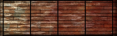

1) Select the Paintbrush tool. Change it's mode to Darken only. Pick a nice dark red color. I like using a round brush with a fuzzy edge, like the brush "2. Hardness 050". Change the opacity to something like 25. Now paint over the wall! Keeping the mouse button down will prevent the painting from darkening itself. If you release the mouse button then repeat the process, it will darken what's already been put down. Here's an example of what the effects are. The sections represent (1) no painting, (2) painting over the area once, (3) twice, (4) three times.
Play with the color. Play with the opacity of the paintbrush. Using selections, try restricting the painting of one color to the siding, and another color to the beams.
Try EVERY PAINT MODE to see what you can do.

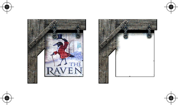

2) Use the section tool to select an area to color. From the Colors menu, select Colorize, and play with the sliders. You can get some pretty ugly effects! But, try reducing the contrast while picking some outlandish color. Here's a cheap effect by selecting an oval on the wood, adding a dropshadow around the selection, then changing the color of the wood. To add the text, I added a text layer in white and set the layer mode to Overlay (I tried them all, and this came closest to what I wanted). I then duplicated the text layer since the overlay effect was too light.
Now, if the intention was to make it look like a wood sign on the building, I'd probably take a section of wood from elsewhere, so the boards didn't line up so well. Also, I'd probably play with other filters like etching the text. But, you get the idea. This is a really good way to make some hanging signs to attach to your buildings, or maybe to take some roofs and paint them up with advertisements on them.

The oval sign example is a good technique to use if you wanted a custom sign to look like it was painted directly on the side or facade of a building. It would even work on a door.
