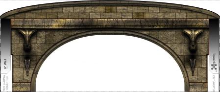

Ok. So, here's what I'm thinking of doing in the short term. I'm thinking of using the bridgewall.PDF file from the Himmelveil Streets set as a starting point (I'll try to make a 3" long version of this wall as well.) Specifically, the anti-warp walls, and I'll explain why. I want to be able to use the walls as-is. To them, I'd like to create "toppers" like those that exist in the SwiftScenics sets - kind of like a railing piece that will glue to the top of the outside of the wall (opposite the side with the anti-warp triangle). I don't know quite yet what the shape of the toppers will take, but I will probably start with something simple before I get creative. I want to spend some quality time thinking about ways to make the toppers not have to be glued onto the walls, too. I'm thinking maybe slots cut into the tops of the anti-warp top to slip them in place. It'd be pretty cool to make a modular system for this! (can you say "fold-flat covered bridges"?)

I try not to invent all new textures for kitbashes - I try to abuse what's already there. In this case, I took the stone from inside the archway and "bent" it to fit my curved top piece. I grabbed bricks from a normal wall and shrunk em down. I'll add a layer of grime over it so that it will hopefully blend in better with the wall below.
I'm learning how to use bump mapping now to kind of emboss/engrave some textures onto the side of the wall. I'd like to have a couple options.
I'm also thinking that I might make special inserts for the posts that I intend to slot these into - to cap off the tops of the posts using something that would blend with the style of the HV Streets set (like using a smaller version of the 'streetlamp' prop might be cool.
I quickly put together a test build, and discovered a little flaw in my "design"... It turns out the piece fits really nicely into the anti-warp wall (better than I had hoped!) but it's got to be 1/4" taller in order to come up over the tile piece that will rest on the wall! D'oh! Other than that, though, I really like how it goes together. I am not going to work too hard on it tonight (or tomorrow for that matter) but I think I'm on to something.
